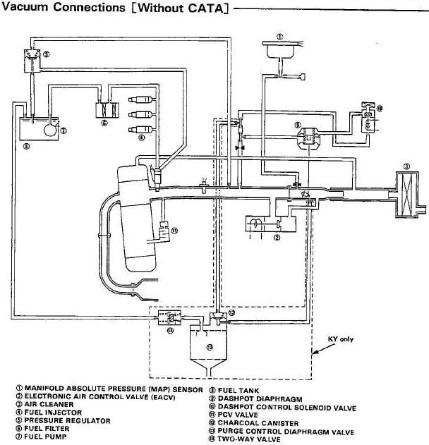

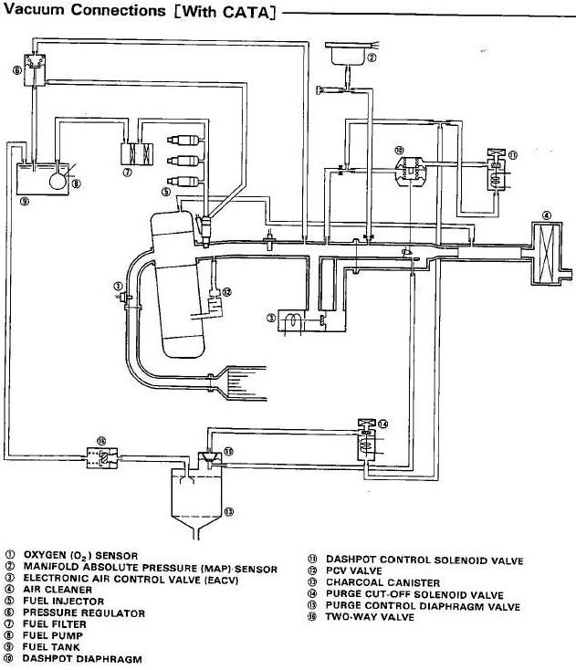

anybody know where what vacuum line goes where on are cars...like I had to get a whole new map sensor and the rest the shit with it at Pick and Steal today....and was wondering what line goes where on are d16's...cant seem to find it in owners manual....a picture will be very useful if you have one thanks....

Either of these work? (Don't know what that CATA thing is though)
http://img.photobucket.com/albums/v473/CivicSpoon/SP32-20051111-234632.jpg
http://img.photobucket.com/albums/v473/CivicSpoon/SP32-20051111-234625.jpg
