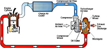

the stock headers on the vette would be replaced with turbo manifolds, which the exhaust side of the turbo connects to. the exhaust flows through the exhaust housing getting it to spool, then exits (center hole) and gos out the downpipe down through the exhaust. The compressor side sucks air in (the center), then blows it out the side. the compressed air blowing out is piped through the intercooler on into the intake manifold.
http://i6.photobucket.com/albums/y214/P4GTR/turbo-parts.gif
http://i6.photobucket.com/albums/y214/P4GTR/turbo-plumbing.gif

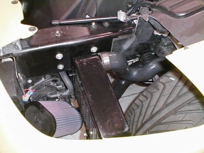

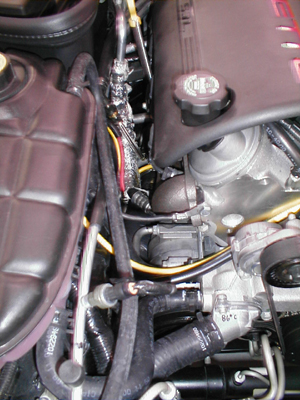

It wouldn't really be hard to do, since 90% of the TT setup is hidden. These are pics from a lingenfelter TT vette.
http://www.lingenfelter.com/images/8279wb.JPG
http://www.lingenfelter.com/images/8280wb.JPG
http://www.lingenfelter.com/images/8271wb.jpg
as you can see, from the top view of the engine, you cannot see the turbines
http://www.lingenfelter.com/images/8274wb.jpg
