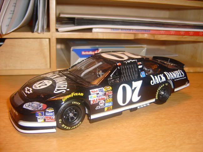

I've had no issues using TS-13 clear. in fact. its all I use.
This one has a Tamiya base, cheap aftermarket decals, and then Tamiya Clear. and it worked out great.

Vric
11-07-2005, 03:14 PM
http://img.photobucket.com/albums/v211/gasman03/FinishedJack21.jpg
Is it supposed to 07 or the 20 is on the wrong side ? :icon16:
gionc
11-07-2005, 03:19 PM
:crying::crying: they replace the old truck with those:screwy:
Jack Daniels = Old No. 7!!
