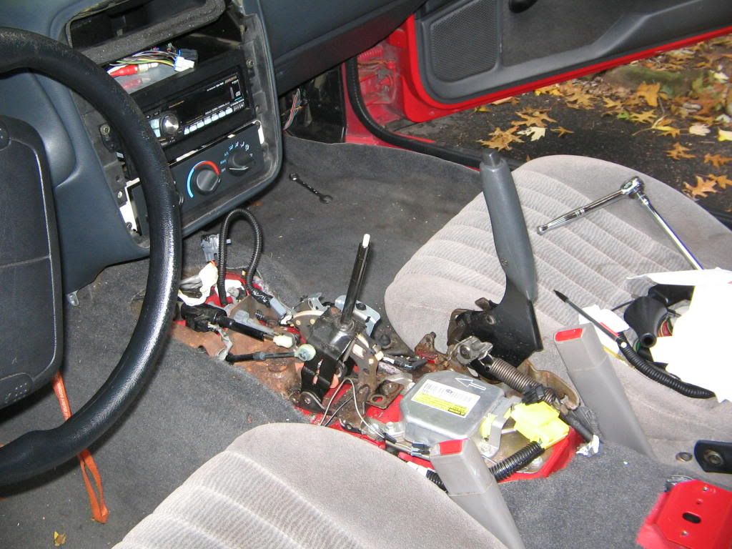

oh and dont worry, there's no airbag sensor up there. The airbag control module (located below the center console) has a built in sensor, a "decellarometer" if you will that it uses, combined with computer input such as speed, how hard you hit the brake, etc. to decide when to deploy the airbags. That's how my 97 is at least.
It is this little silver box...
