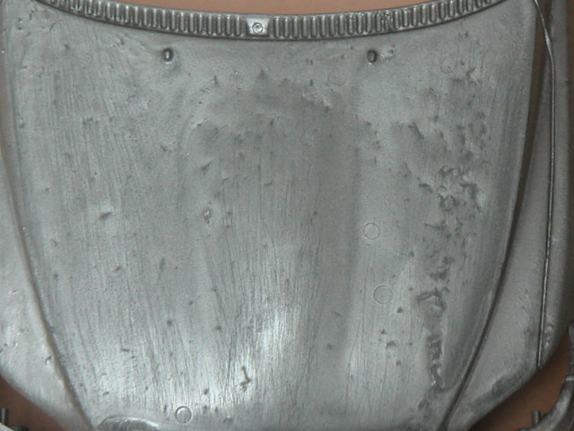

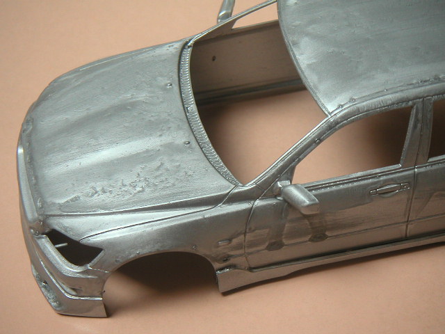

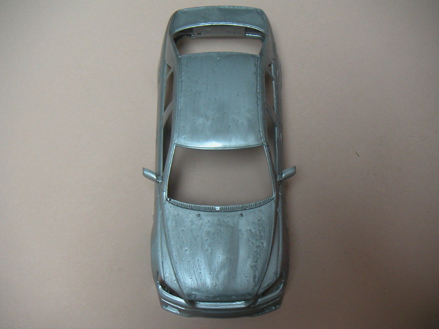

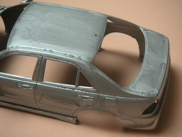

here it is before i put it in CSC
http://files.automotiveforums.com/uploads/860005Pict0129.jpg
http://files.automotiveforums.com/uploads/344017Pict0130.jpg
http://files.automotiveforums.com/uploads/906223Pict0131.jpg
http://files.automotiveforums.com/uploads/846264Pict0132.jpg
http://files.automotiveforums.com/uploads/870945Pict0133.jpg

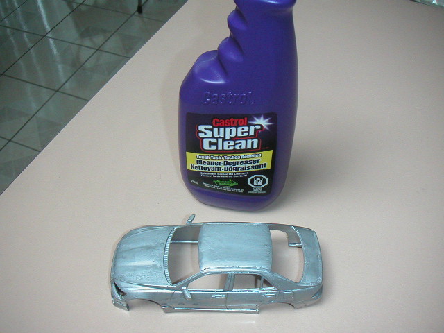

OH so you got the spray version, huh!
Go to the automotive section and you'll see that CSC is available in big huge gallon containers that you pour.

did the CSC get the job done in stripping the old paint?

Can u tell me the process u used to paint it - what paint did u use and where did u paint it - has it got wet with water?
Im sorry its got messed up - hopefully the csc will work - Then your baby can be shinin'
Im sure we will all help as much as possible - The only thing is that you can learn from this and perhaps change your approach next time?

There's a lesson to be learned here
ALWAYS USE PRIMER!!!!!!!!!!!!!!!!!!!!!!!!!!!!! :devil:

Yeah man, I'm not making fun of your car dude, I've had worse trust me. Practice makes perfect, the important thing is you learn what you did wrong and correct it in the future, in this case, I'll tell you what I think happened:
1.) No primer, slippery plastic
2.) You said it rained immediately after you sprayed it, which means the air must have been very humid. On every can of spray paint it will say DO NOT SPRAY IN HIGH HUMIDITY. Trust those words!!
