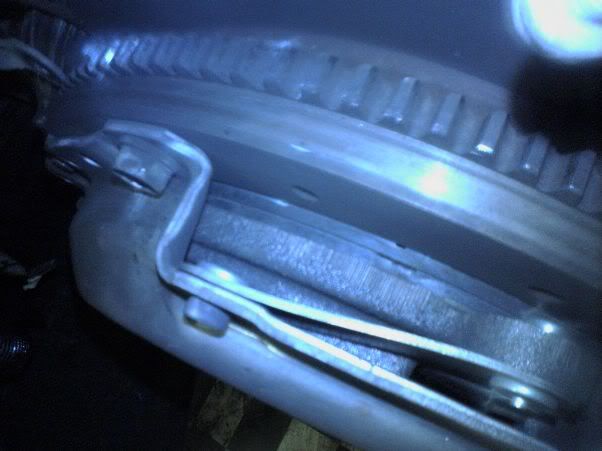

Does this clutch look bad to you? Replace or re-use??
EDMUND65
10-30-2005, 12:47 AM
http://i13.photobucket.com/albums/a285/crazydriver7686/clutch.jpg
Looks alright to me.... wondering your opinion

kjewer1
11-01-2005, 01:35 AM
You can't see the thickness of the material left before you hit the rivets on the disc and you can check pressure plate warpage unless you remove the clutch. That picture doesn't give us anything to go on :)
EDMUND65
11-01-2005, 08:56 AM
oh sorry, i thought you could see the thickness of hte clutch disc..
kjewer1
11-01-2005, 08:58 AM
I can, but it doesn't mean anything. The actual thickness doesn't matter, even if I could measure it over the internet. The distance from the face of the disc to the top of the rivets will tell you how much life is left in the disc though (assuming you know what a new disc looks like in this dimension, or have a new one to compare it to).
EDMUND65
11-01-2005, 10:08 AM
wlel i have aspace sitting right next to the car w/pressure plate... should i swap? i did a reverse burn out and totally smoked the clutch, i kno it was stupid but i had some high level of anger
97GSTspyder
11-01-2005, 01:02 PM
just get a new clutch and throw it on. if you spent that much time removing the transmission, then it's only smart to replace the clutch. i agree with 95GSXracer, we can't tell from that pic. just make sure when you take the clutch assembly off, you lossen the pressure plate to flywheel bolts evenly in a criss-cross pattern.
EDMUND65
11-01-2005, 02:05 PM
my problem is i have no money.... so im going to have to make due with wht i have, the tranny removal is no big deal... 40 mintues total to drop it.... and another problem im goin to have is no alignment toolll..... but tonight is when im goin tothrow everything back in
