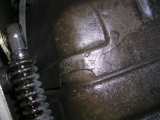

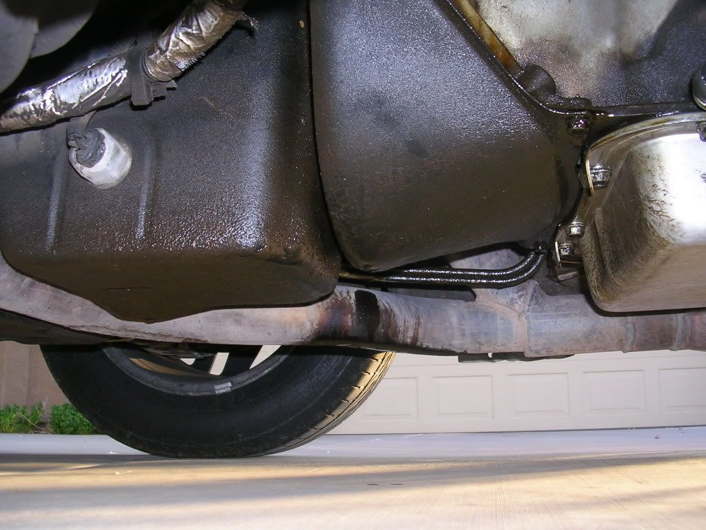

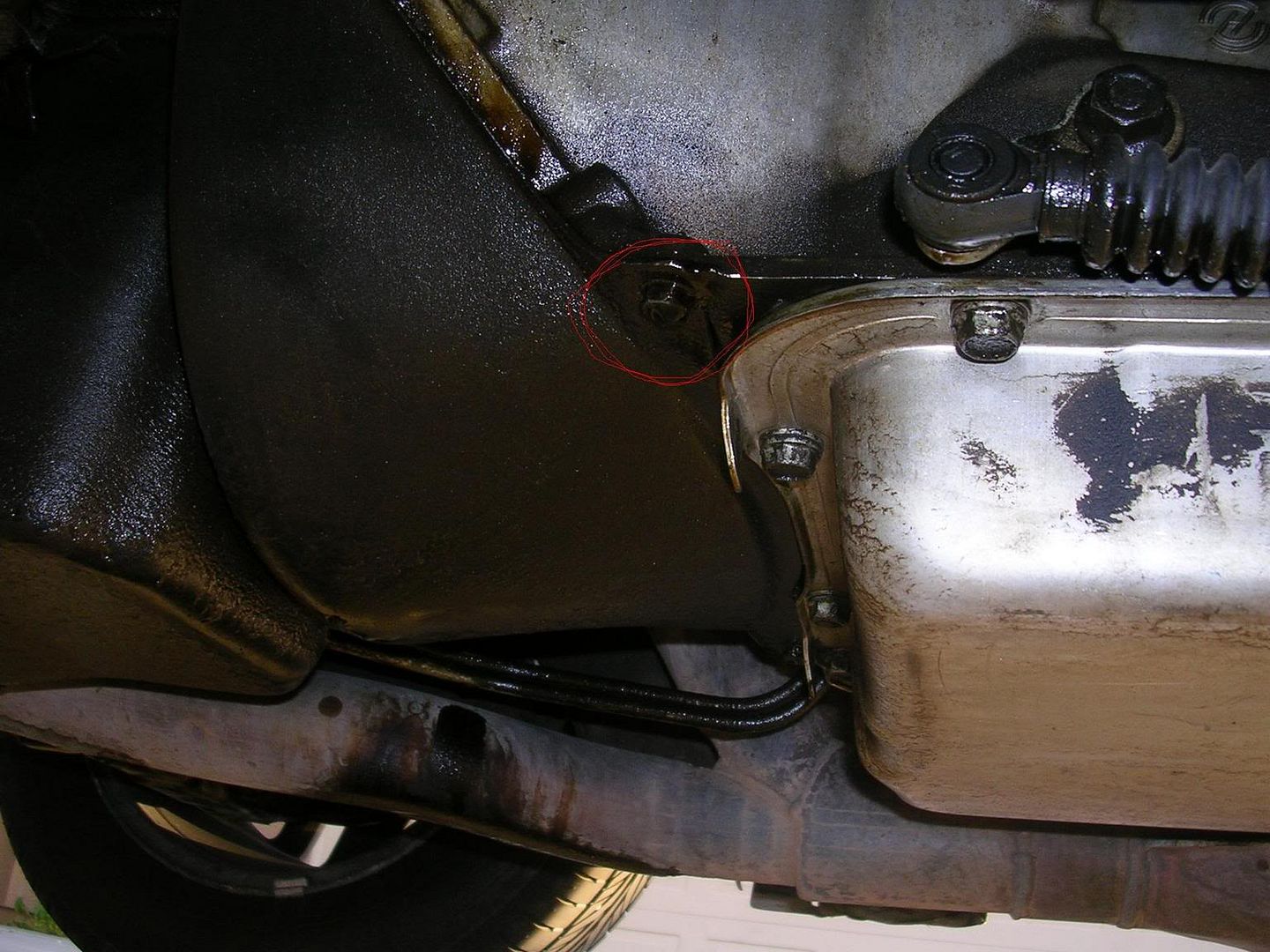

Ok, I still cant find the "source" of the leak cause the engine is covered in a coat of oil, so its kinda difficult. I tried to spay it off with a hose, got alot but not all. I also have some engine degreaser that I am going to try using. I have some pictures from where it was dripping, I dont know what they lead up to, so i need some help. :biggrin:
http://i19.photobucket.com/albums/b151/x8xViperx6x/OilLeak001b.jpg
This is where it is dripping off of.
http://i19.photobucket.com/albums/b151/x8xViperx6x/OilLeak005.jpg
http://i19.photobucket.com/albums/b151/x8xViperx6x/OilLeak002.jpg

cuda_dude
11-02-2005, 08:44 PM
find the highest place the oil is at... oil wont travel up.... and the rear main seal is the most common area for an oil leak (not saying this is your case but its the most likely cause)
