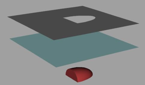

hirofkd
10-12-2005, 10:14 PM
Well, kind of you can. What's missing in the example is another frame to hold the heated plastic sheet down. Get a thick styrene sheet (like 1.0 mm) and cut out an opening slightly larger than the cross section of the object, and use it to hold down the plastic tightly.
http://i21.photobucket.com/albums/b258/hirofkd/550%20maranello/vacsetting.jpg
But even with this method, what you can't do is to make the roof of the FD3S or C5 Corvette, whose center part is concave, and a shape like that has to be vacuum formed.
