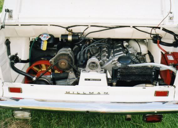

Owned my car since August 2000. Started restoring it 2 years ago and finally got it completed in May this year. Done a few car shows and a trip to France (I'm based in the UK). Took it to the club's National event and won second prize in it's class.
Not many got exported really so incase you don't know what it is, it's a Hillman Imp Californian. Built in Scotland. Was originally an 875cc engine but I've upgraded to a 930cc from a Sunbeam Talbot which gives it a bit of extra low down grunt. The interior is original and the paint is the factory colour. Fitted two brand new rear wings, two brand new doors and a brand new boot lid on the front (rear engined). As you can see, complete strip down and bare metal respray. Many parts reconditioned, many new parts. Front brakes upgraded to Ford Fiesta disks and the clutch release bearing upgraded to a Rover roller bearing type.

The engine is mounted at 45 degrees which not only drops the weight lower to the floor, but spreads the weight across the car. Not that there is much weight in the ickle ally block.
