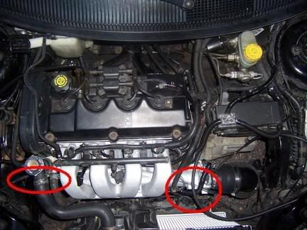

11-08-2005, 09:41 AM
ok it must have been someone else or another siteAny updates on your project? I found a picture of one that might help you out...
http://i6.photobucket.com/albums/y243/rtforme/Enginebay.jpg
