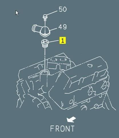

I got a 1995 and mines overheatin im goin to try the t stat,where the hell is the damn thing

UB10 - Good onya mate! It's always great when someone posts details about their solution to a problem.
mwm - diagram from http://www.myisuzuparts.com/ thermostat is item #1
http://i190.photobucket.com/albums/z200/boritz_bucket/ThermostatSmall.jpg

It's actually in a very accessible spot and easy to replace. Don't forget the gasket.

Lucky you. On 2nd gens its under the intake pleneum :screwy:. The plenum has to come off to replace the t'stat. :banghead:
