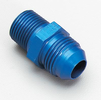

This is the order these parts come off the rails....
Rail....3/8NPT to -8AN fitting (http://static.summitracing.com/global/images/prod/large/ear-981608_w.jpg).....-8AN 90 Degree autofit (http://static.summitracing.com/global/images/prod/large/ear-309108erl_w.jpg).....fuel line
Now, I am thinking I just need to get an -8AN T, and a couple -8AN easyfits. Does that sound right to install the T?

Being an LS engine it is sequential injection, meaning that the 8 injectors are fired one at a time, so no single injector should be getting less pressure than any other.
I see that you are using a 3/8" fitting from the rail and going into a #8 line. 3/8" is a #6 line, having it fed by a #8 (1/2") line won't do anything for you, except make it more expensive (#8 line costs quite a bit more than #6) If you already have #8 line in the car to go to the fuel rails, I'd get 2 fittings to go from the rails 2 pieces of #6 line with fittings for both ends, a T fitting with a #8 on the end and #6's on either end of the "T". And for extra insurance...run the line from one rail to the other like in your first pic. This way you know you are getting fuel to both rails. But do you need one end of a rail to go to return?
