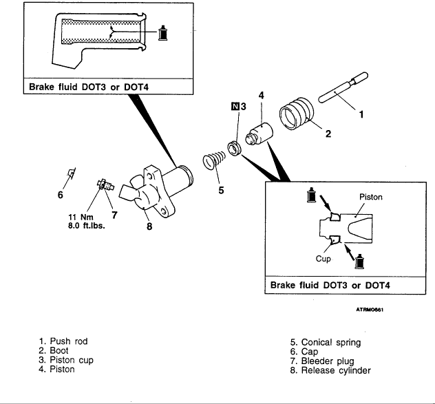

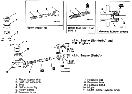

this is all it shows on alldata, sorry man, hope it helps, maybe you could by rebuild kits... the slave cylinder should be right outside your tranny or at least thats how it is on my 1g, and the master cylinder is usualy located on the firewall above the pedal...

Thanks EDMUND65 for taking the extra time to post up that diagram, I appreciate it. :smokin:
