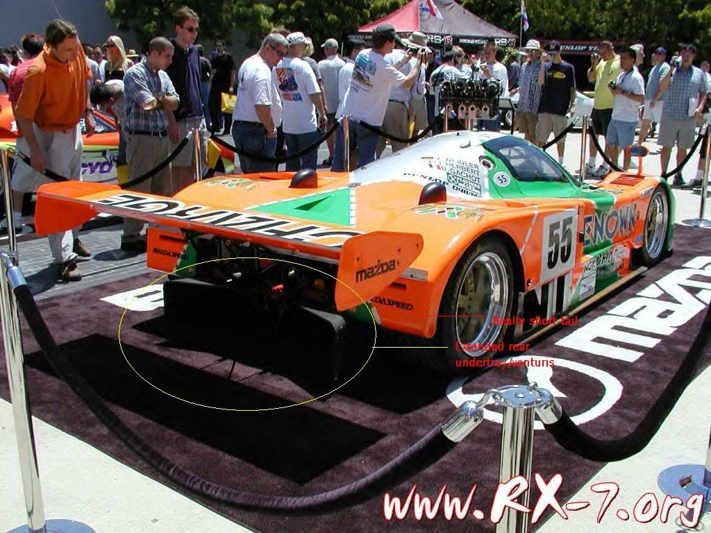

NewyorkKopter
09-28-2005, 02:33 PM
oo so its like
Short Tail: Provides more neutral precise steering at the cost of high speed stability
Long Tail: Provides more high speed stability at the cost of steering response
also is this why the 787B had a really short tail, while the Venturis underneath stuck out more. did that give it a long-tail like effect??
http://img.photobucket.com/albums/v178/NewyorkKopter/Therearviewofthe91787B.jpg
2.2 Straight six
09-28-2005, 06:18 PM
i think the reason for that sticking out more is because of the rear drivetrain, you see with the engine in the middle you often have the driveshafts exiting the gearbox casing in the middle, like there's the bellhousing where it "joins" the engine then between that and the end of the gearbox there's the drive shatfs, its complicated how the mechanics inside the gearboxes work on this kind of application.
so the diffuser there is placed im pretty much the same place, and appears the same size as a long tail's one
its like, for example (and this is only an example, apart from the mclaren F1 i dont think this has happened) two cars use the same chassis, same engine an gearbox, drive shafts in the same place same length etc.. now the engineers cut part of the body work off an longtail, and make a short tail, but want the same size diffuser, hence it sticking out from the tail of the car.
i hope that makes some sense, if not tell/pm me an i'll sorta draw you an explaination of what my jumble of words is meant to mean.
its like the diffuser is the same size, it only sticks out because one's with a longtail cover it up.
NewyorkKopter
09-29-2005, 05:42 AM
O yea I forgot, because the gearbox if not wrapped around with venturi's would be sticking out from the back of the car because the 787b has a really short tail. So they probably extended the diffuser to equal the length of a longtail's diffuser to get that high speed stability and the short-tails agility
