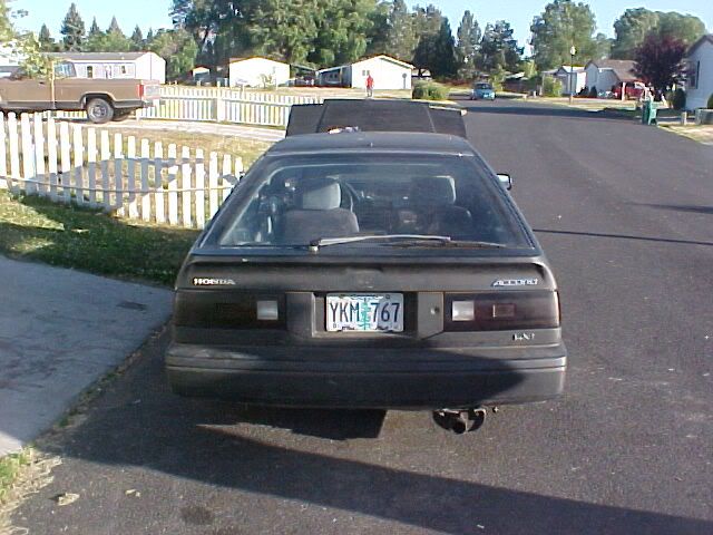

http://i17.photobucket.com/albums/b76/Slipknotcraig133/Tailights.jpg
Those are on my accord. I cleaned the tailight up real well with warm water and soap. Then i dried them and masked the back of the car. I got this stuff called night shade. It is a transparent black and this non yellow acrylic clear coat kind of stuff. I put 3 coats of black on with 30 minutes between each coat and then let it sit for 2 hours after the last one then i put 2 coats of acrylic on it with 25 minutes between each coat of that then let it sit overnight. Its kind of hard to do. I didnt really like the way mine came out. In some places my tailight is spotted and it seemed like i took a while doing it with constant strokes and equal distance the whole time. Also i was shaking the can alot. So im not to sure what caused the problem something i did probly lol.
