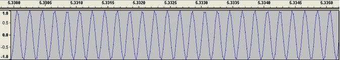

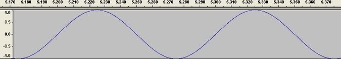

paul, i wasnt refering to staying AT peak longer i was refering to staying at higher voltage for a longer duration... over a set period of time the ammount of time each spends at any particular amplitude is the same HOWEVER the lower the frequincy the less often the amplitude changes dramatically.
see pictures, the first is a 10hz signal and the next a 5kHz signal. also look at the time elapsed at the top.

-3dB means it is recorded at 1/2 amplitude.
http://i11.photobucket.com/albums/a167/CBFryman2/10Hz.jpg
http://i11.photobucket.com/albums/a167/CBFryman2/5kHz.jpg
and BTW

and BTW
We see what you're saying, but your argument makes no sense, the speaker will behave the same way with either of those (except the sub's inductance will limit the output of the 5khz wave), as will the amp.
And -3dB is 70% of the original amplitude, half would be -6dB.
