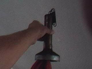

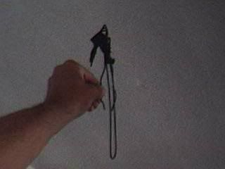

Okay this is what I did. After I took off the screws I took a clothes hangar like the wire ones. I folded in on itself several time so it was pretty sturdy and made a hook out of it. just enough to where it would fit inside the exhaust hole and hook on the other end of the silencer. But before I did that I took electrical tape and wraped it around the whole hanger like eight times so it wouldn't just come apart. Now I left loop at the end which I ran a rag through. So the hanger is shoved in the whole and hooked on the edge. The end of the hanger is barely sticking out of the end of the exhaust and there is a rag running through it. I then planted myself firmly and started pulling as hard as I could. the hangar came apart the first time but I set it up again and it popped right out. Let me see if I can find the hanger and I will post a picture of what I am talking about in this post.

http://i20.photobucket.com/albums/b229/defiancy3/Image003.jpg
http://i20.photobucket.com/albums/b229/defiancy3/Image004.jpg
Sorry they are kinda crappy quality, but I hope you get the idea.
david-b
09-16-2005, 10:32 PM
That shit is great! When I tried the hanger, it didnt work. Ill have to try it like that! Thanks
