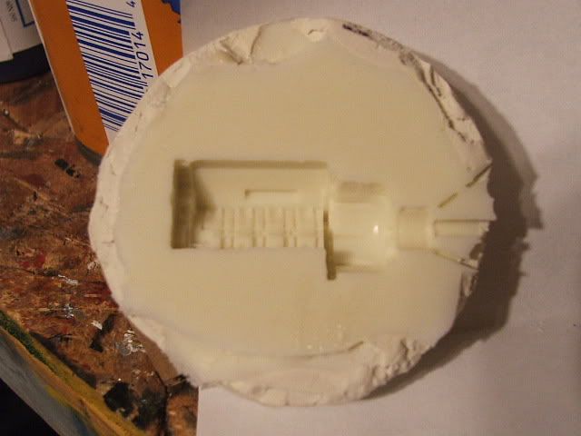

well.....I just poured the resin.....the two part mold didn't work out.....this resin sets up FAST. they tell you a 1:1 mix. and I mixed it exactly 1/4 oz to 1/4 oz....and This stuff set up before I got maybe an 1/8 of an oz in the mold....so I broke it down and am pouring it in halves.....We will see how it goes...hopefully I'll have some finished product up for you guys in an hour or so

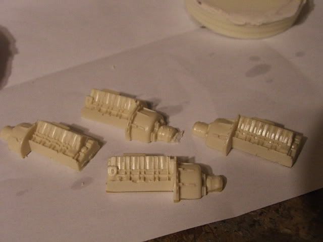

I've poured 4 engine halves so far!! lol. As you can see in the picture, I used WAY too much mold compound..I should have planned my molds a little better. Lessons learned though.

you can see I had some bubbles on the bell housings in the ribs......I need to sort that out....or just sand them off!!!
MidMazar
09-09-2005, 11:06 PM
wow they look like they came out great, they look perfect actually, so why do resin kits from actual companies come out like garbage?

Castings look great! Was this all made by the stuff in the kit?
white97ex
09-10-2005, 08:28 AM
yep
