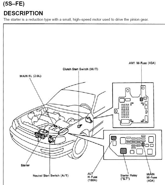

It will not crank at all. We have found, however, that by turning the key slowly our problem is diminished. The starter relay is located where?

Thanx Brian, I will check that relay post haste--K
