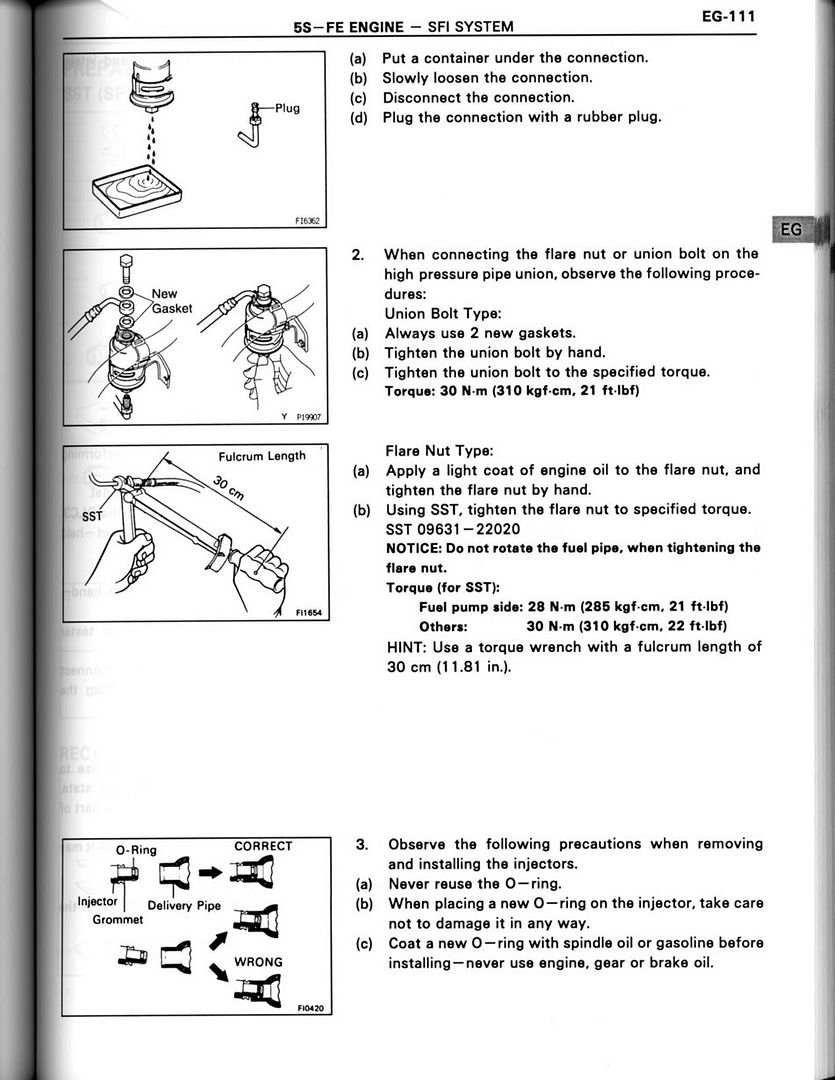

Brian R.
08-24-2005, 11:52 AM
I don't believe that removing the cap from the fuel tank will have any affect. The high pressure fuel line is not vented into the tank. The fuel in the high-pressure line may bleed off into the tank over time, but removing the cap won't relieve the high pressure as found immediately after shut-off. The fuel line is supposed to hold pressure of 21 psi or greater for 5 minutes after engine shut-off - otherwise the pressure regulator or pump is defective.
My recommended procedure posted above was from the Toyota service manual.
http://i16.photobucket.com/albums/b8/rogersb/Fuel1.jpg
http://i16.photobucket.com/albums/b8/rogersb/Fuel2.jpg
