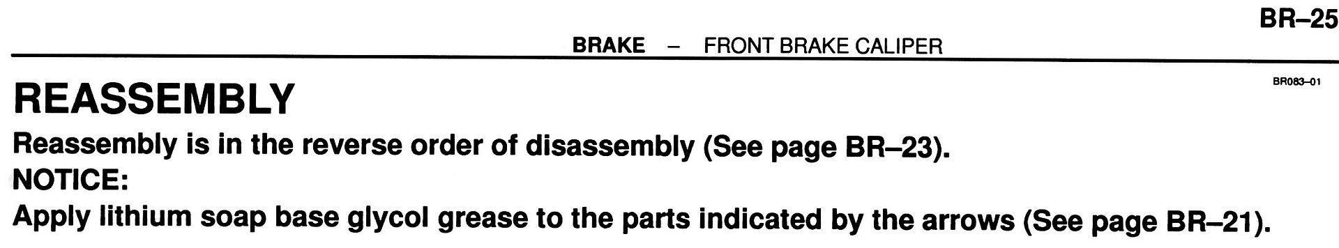

Brian R.
08-18-2005, 10:14 PM
http://i16.photobucket.com/albums/b8/rogersb/4Runner%20Brakes/4RunnerBrakes1.jpg
http://i16.photobucket.com/albums/b8/rogersb/4Runner%20Brakes/4RunnerBrakes2.jpg
http://i16.photobucket.com/albums/b8/rogersb/4Runner%20Brakes/4RunnerBrakes3.jpg
http://i16.photobucket.com/albums/b8/rogersb/4Runner%20Brakes/4RunnerBrakes4.jpg
http://i16.photobucket.com/albums/b8/rogersb/4Runner%20Brakes/4RunnerBrakes5.jpg
http://i16.photobucket.com/albums/b8/rogersb/4Runner%20Brakes/4RunnerBrakes6.jpg
http://i16.photobucket.com/albums/b8/rogersb/4Runner%20Brakes/4RunnerBrakes7.jpg
http://i16.photobucket.com/albums/b8/rogersb/4Runner%20Brakes/4RunnerBrakes8.jpg
http://i16.photobucket.com/albums/b8/rogersb/4Runner%20Brakes/4RunnerBrakes9.jpg
rayjj
08-18-2005, 10:20 PM
Thanks for the pics, looks pretty straightforward. Hopefully I can figure out what else is going on to cause the premature failure.
