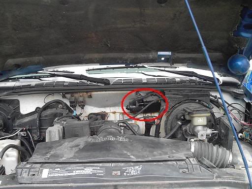

where is this circuit board located on the truck, im having the same problem and would like to check it out.
i_cry_at_night
08-06-2005, 11:14 AM
http://img.photobucket.com/albums/v343/adjacent/IMG_0029.jpg
this is where it is located
there are three screws, take them out then pull the cover off and the board with come out, you may need to pry where the harness meets it to get that out
