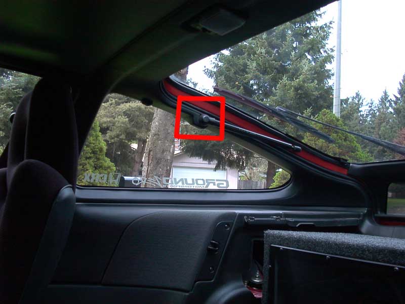

On rainy days, there is a little leak inside the car, it doesn't leak much, but I don't want it leaking at all.
http://files.automotiveforums.com/uploads/319333InsideLeak.jpg
Does anyone know how to fix this?
Kunundrum
04-27-2002, 11:52 PM
it's your rear windshield washer nozzle leaking... i fixed it with a little silicone just seal up between the sprayer an the body
