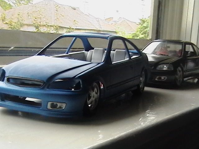

went to get a civic kit at walmart and visited the automotive paint dept. and got some
http://i3.photobucket.com/albums/y78/imeonic/Scale%20JDM%20build/IMGA4935.jpg
so
boredom + sale kit on autopaint =
addition to my civic family...lol
http://i3.photobucket.com/albums/y78/imeonic/Scale%20JDM%20build/IMGA4940.jpg
http://i3.photobucket.com/albums/y78/imeonic/Scale%20JDM%20build/IMGA4939.jpg
[/b]
nothing special...
just dropped it...everything stock...even the rims are OEM
one modification...cold air intake..thats it ;)

is it just me or does the paint look flat?
imeonic
07-23-2005, 01:49 PM
yeah...dunno wats wrong..its supposed to be metalic...havnt applied clear coat yet..
will gloss work? blast another coat of paint?

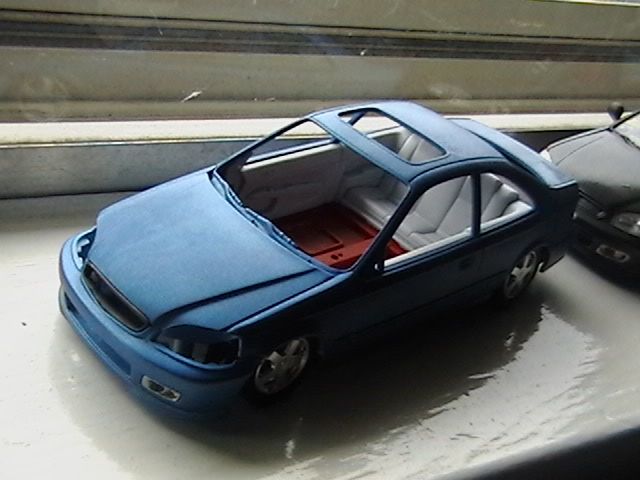

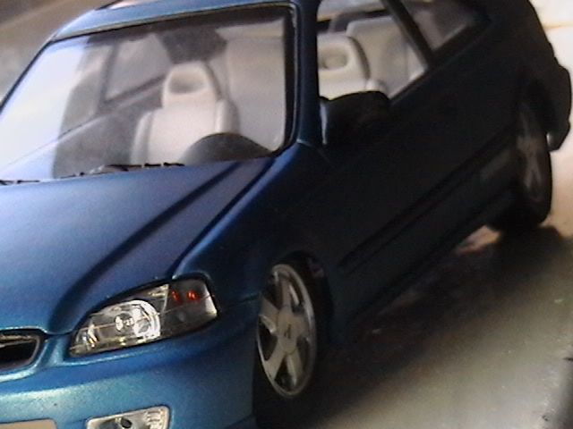

updates:
i shaked it for 15 mins..then
i dipped the can in hot but not boiling water...
blasted the hood again with another coat...
http://i3.photobucket.com/albums/y78/imeonic/IMGA4959.jpg
still looks flat?maybe clear coat will do..or some scratch x...

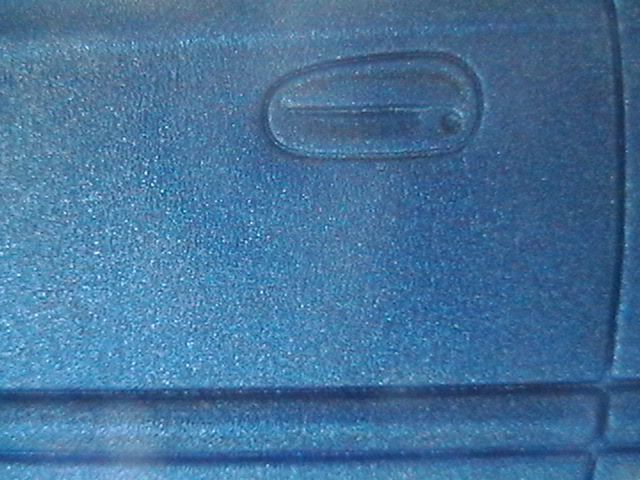

here are more upclose detailed paint pics...
http://i3.photobucket.com/albums/y78/imeonic/IMGA4960.jpg
http://i3.photobucket.com/albums/y78/imeonic/IMGA4961.jpg
http://i3.photobucket.com/albums/y78/imeonic/IMGA4962.jpg
emperorsupra
07-23-2005, 03:56 PM
wtf, it still came out flat ouch thats got to hurt you might wana hit it with some clear
MidMazar
07-23-2005, 04:03 PM
clear it because its a metallic paint, polish it after clear coat. It will look like a flat type of paint if you don't clear it. Don't use scratch x before clear!!!!

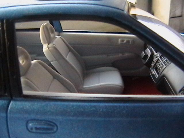

for now..im doing interior detail..at first i was thinking of keeping the seats that paintless color..lol it looks clean on blue..
http://i3.photobucket.com/albums/y78/imeonic/Scale%20JDM%20build/IMGA4966.jpg
tsk tsk..who reclined the seats???lol
http://i3.photobucket.com/albums/y78/imeonic/Scale%20JDM%20build/IMGA4965.jpg
Feint Motion
07-23-2005, 10:34 PM
Nice! Clear coat should clear up that dullness. Probally happened because it was humid outside and you can was a little bit too cold/warm.
Whumbachumba
07-23-2005, 10:39 PM
Metallic colors shouldn't be shaked, they need to be stirred in a circular motion. Hold the can by the top and move your hand so the bottom of the can is rotating, but the top is not moving much. This will stir up the paint better than if you shake it. It works with non-metallics also.

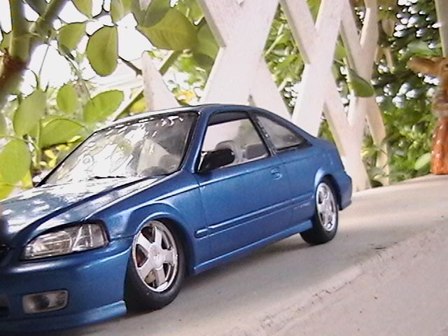

imeonic
08-01-2005, 07:37 PM
needs more buffing i guess...
http://i3.photobucket.com/albums/y78/imeonic/Scale%20JDM%20build/IMGA5012.jpg
evo8owner
08-01-2005, 09:10 PM
Dupli-Color Paints Are Great! You Just Have To Wait & Polish It Out.
