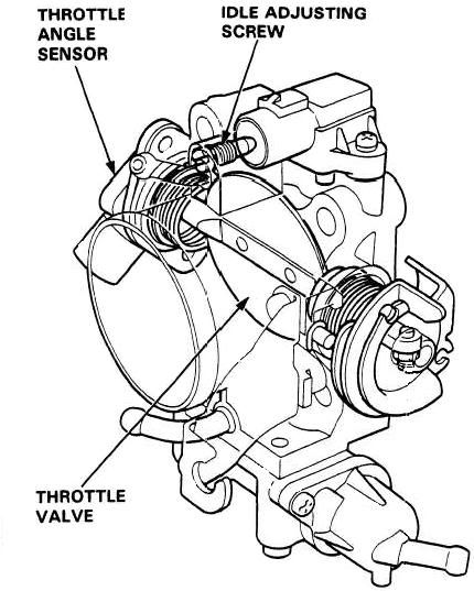

i just bought a crx w/b18(ls) and it ildes at 3-4k rpm and was wondering how do i lower it down if it is possible my friend told me there a screw or something on the head that controls it but not sure
CivicSpoon
06-26-2005, 06:26 PM
That pretty up there in the rpms. But yes there is a screw, it's on your throttle body.
HontegraGSI
06-28-2005, 01:27 AM
I have the same problem, but mine idles at less than 1k rpm. will this "screw" solve my problem too? does it affect the way it runs?? And where is this screw located at? please help me and zerocrx out...
CivicSpoon
06-28-2005, 02:06 AM
