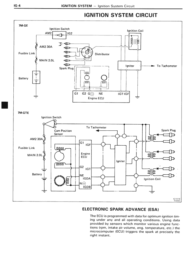

i was just wondering if the firring order in a 7mgte ignites 2 positions at the same time Ive viewed the coil firring order and it looks like it fires 1 and 6 then 2 and 5 and 3 and 4 at the same time so what i mean is that it ignites 2 cylinders at the same time in the firring order correct? I'm arguing this with someone so let me know so i can say I'm wrong or right

Looks like you're right.
Firing Groupings on this page:
http://www.cygnusx1.net/supra/techtip/stats.html
http://i16.photobucket.com/albums/b8/rogersb/IG_04.gif
