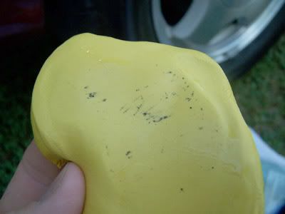

I watched a few videos to get the general idea then bought Mother's clay bar kit and tried it today for the first time. I must say that it took quite a bit longer than I had expected. I spent 2 hours washing/drying, claying, waxing, etc. However it was time well spent. I didn't have any residue that looked like what the videos showed, but I did have something on the clay after use (as seen in this photo): http://i130.photobucket.com/albums/p278/georgew84/100_3923.jpg
For the record, I put a towel on the ground below the section I was claying (to keep from ruining the clay). I clayed a section, wiped it off, then waxed.
The only place on the car that pulled any noticeable debris was on the rear quarter panels behind the tires and on the rocker panels. Looks like road tar. I did also notice that the wax went on smoother after claying. Having learned how long it can take to clay and wax a car, I may not do it as often as I originally thought I would. I thought I would do it every other month, but I'll probably just do it 3 or 4 times a year. Only reason I want to do it so much is because I live in the midwest where we have a lot of balmy summers and nasty winters. Plus there is a lot road construction this summer and I live in the country in dusty conditions.

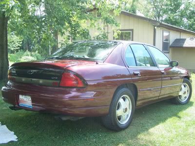

Here's a pic of the luminator after a clay and wax...
http://i130.photobucket.com/albums/p278/georgew84/100_3924.jpg

The more often you do it, you can get a routine down pretty easy with practice. I'll clay and wax or paint seal a car in about 40 minutes at work these days. That black stuff in your clay bar is the junk it pulled out of the paint, but you should also notice your car's paint feel much smoother. Just fold the clay bar over on itself for next time you clay or if it gets too dirty, just toss it in the microwave for about 30 seconds to soften it up and work it for a bit. I know what you mean though, living in Wisconsin, I clay and paint seal my car every 2-3 weeks though
