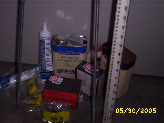

i made use of the 10% Vetrian discount at lowes and saved myself a few bucks....too bad lowes doesnt have 3/4" MDF sheets, only homedepot, in gainsvill, 30min away....
http://img.photobucket.com/albums/v201/CBFryman/b4f7fbd6.jpg
construction will begin in a few weeks upon receiving the Ava18. and the amp will be purchased 2 paychecks from now... BX1205D :)
My system will go boom like so... 6cuft tuned to aprox 29Hz (i changed to 5/8 threaded steel where i had originally calulated for 2x2) with 77sqin of port area side firing.
