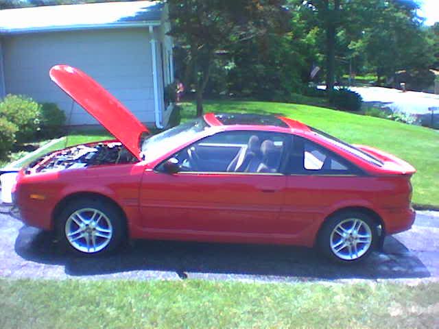

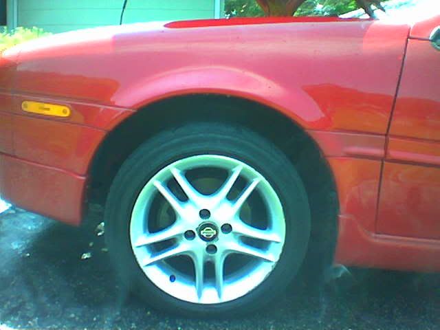

i checked the spark plugs and they dont have oil on them but the tips are really black. do you have any photos of what the car looks like with the skyline wheels on (sideshot)..

Well, make sure to take care of those plugs(remeber, NGK or Denso, not Bosch), but those gaskets might still be good. I'd check out the valve cover gasket still. Should be pretty cheap at a local parts store. I don't have any recent pics of my car with the rims on it, but here are some pics of the previous owner of the rims(on his NX2000).
