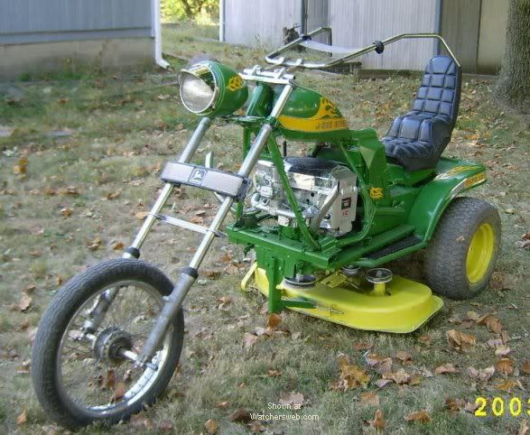

No rice burners for me. Born in Detroit. But I do like the new Chrysler's. And that hasn't happen since 1964!!!!!! OK, 1969, Roadrunner and GTX were nice.
I'm thinking of selling the GTX, and buy a bike.
http://img.photobucket.com/albums/v425/kustomkid54/26048-1f.jpg

Jesus Christo KustomKid54 what the hell is that. Looks like something out of "Pimp My Ride" gone bad. lol

Coolest lookin grass machine I've ever seen, Man I could cut the hole neighborhood with that puppy.
