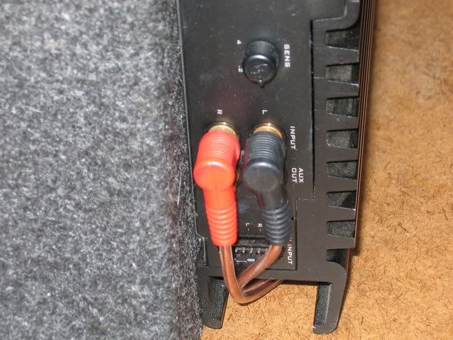

http://i5.photobucket.com/albums/y187/Im2Much4U/d98283d2.jpg
The RCAs plug into the front of my amp and I ran them underneath the amp....

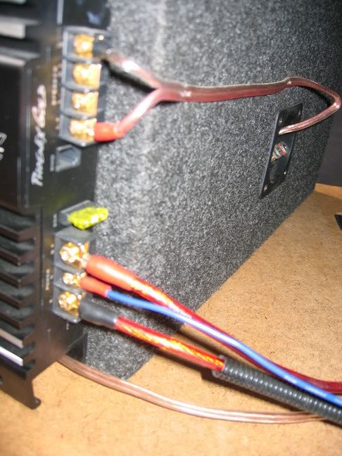

http://i5.photobucket.com/albums/y187/Im2Much4U/19ae77cb.jpg
On the back of the amp we ahve the power wire (red wire), the ground wire (red one with black cover) and the wire to the head unit (blue wire). Plus the RCAs...

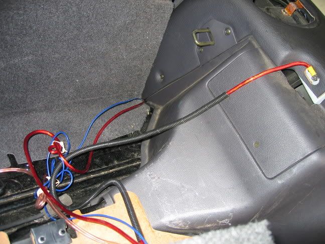

http://i5.photobucket.com/albums/y187/Im2Much4U/bf170c9a.jpg
I grounded the sub right there and then ran the power and other wire down teh right side of the car (under seats, under door panel, etc). FOr this, I then drilled another hole through the fire wall on the passenger side (don't knick a fuel line like I did :rolleyes: ) so that the power wire would come into the engine bay right by the battery. The RCAs, I ran down the drivers side of the car.

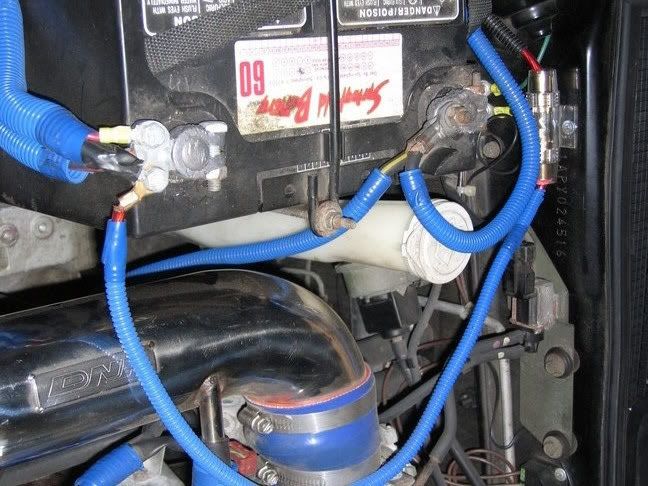

http://i5.photobucket.com/albums/y187/Im2Much4U/IMG_0260.jpg
Power wire come up through the firewall and engine bay on the left, throuth the fuze...
http://i5.photobucket.com/albums/y187/Im2Much4U/IMG_0262.jpg
And connects to the battery.
