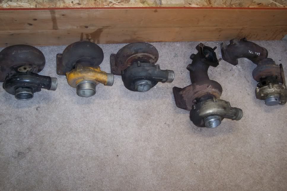

Here is all the turbos (except for 2 more that i still havent brought inside from the car yet)

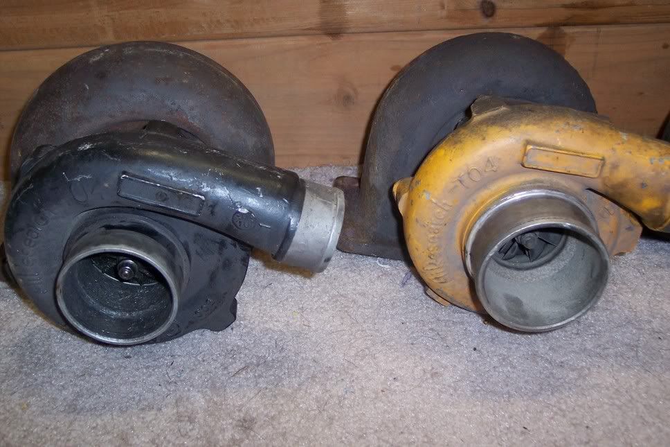

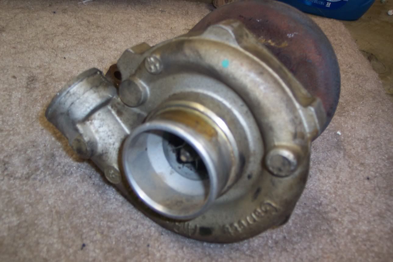

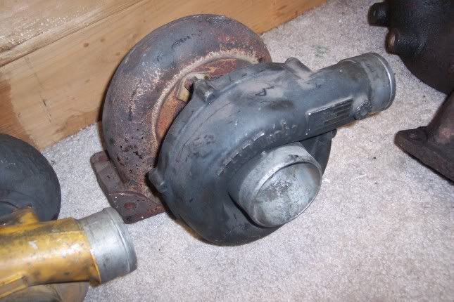

Here are 2 TO4's, the one on the left has a fuc*ed up compressor housing, and the one on the right has a cracked turbine housing. Im gonna trade the good/bad so i have good/good and then rebuild the bearing housing.

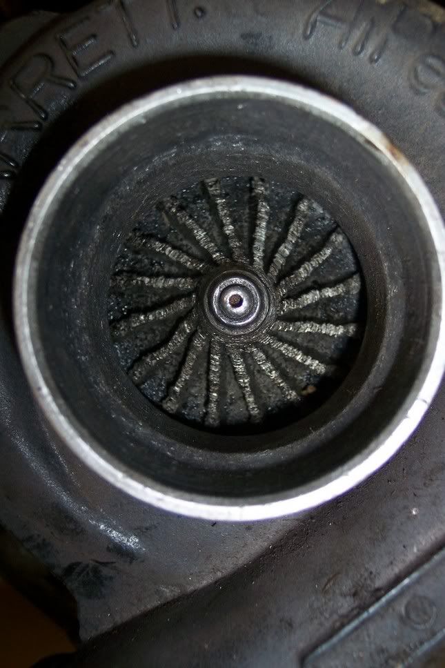

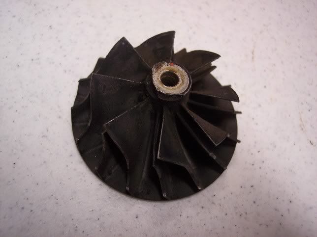

Here is the inside of the one with the messed up compressor housing, can you see the teeth on the compressor blades? because there are none lol

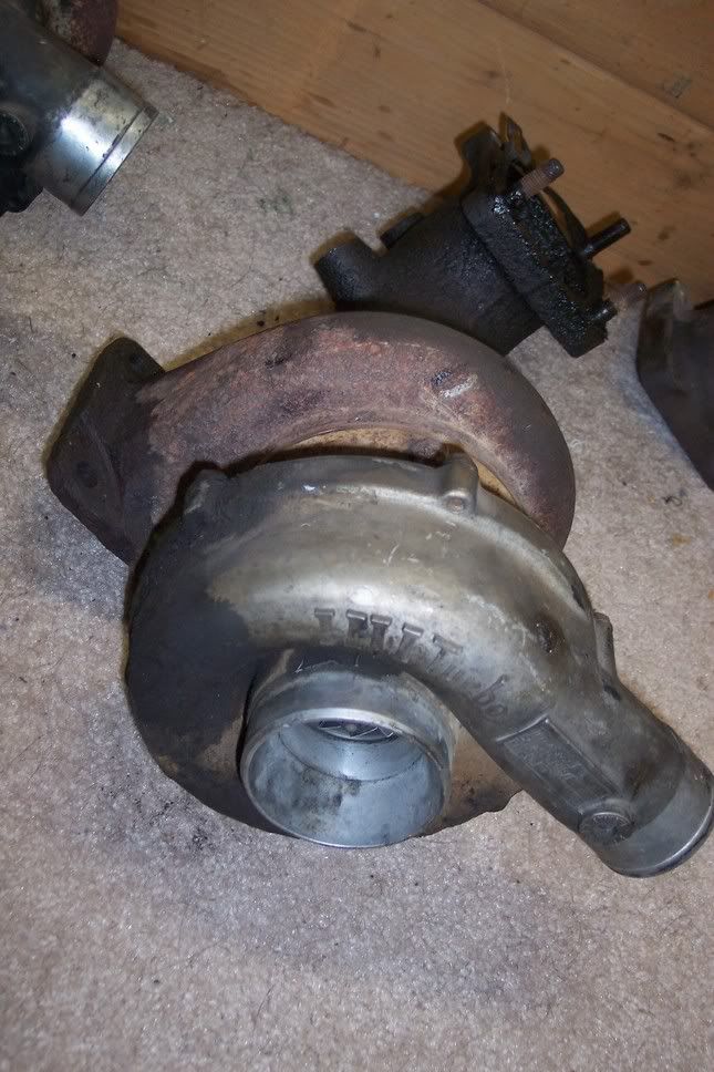

Here is my IHI RHB7 turbo that has a chunk of downpipe stuck where it screws into the turbine housing (sounds wierd but most of the turbos i get arent bolt type housings, they mostly are the ring screw in ones)

damn those are some messed up looking turbos. the t04 on the left looks liek what happend to mine when pieces of welds on my intake pipe broke and hit the blades, not a pretty sight, i would not even make 9 psi with the wastegate signal blocked. however with that i still manage to make 214whp on 6 psi. heh but that was still a disapointingly low number for me.

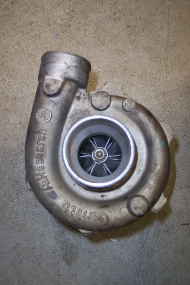

And no, in not going to randomly interchange parts to make something useless. ive been doing this for a while now, one turbo at a time though and have spent the money and also saved it. This isnt a first timer. The two TO4B's are identical, except one has a bad compresser housing, and the other has a good compressor housing. Ill just rebuild the bearing housing, put the good compressor housing on, and put everything back togethor to have a good turbo. I wouldnt swap something if it didnt come off, or be the exact same as the part i was switching.
If anyone knows anything about garretts turbo's let me know, because there is some wierd part number on the to4 and i was wondering if you could explain these numbers. It says KB-TO4B83...

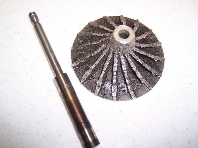

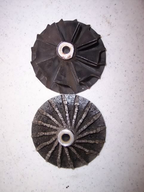

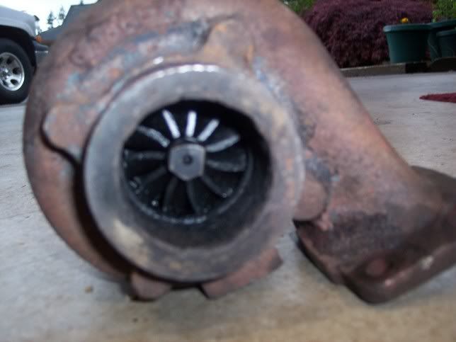

Here are some more before and after pics of the messed up TO4, with a broken shaft. And the little turbo next to a CD as asked...

you may want to clean them with a carbon disolving agent. i dont know man, that one still looks like bad impeller blades. Like some backfireage happend to it. Unless its just an optical illusion from the angle of the pic.
i wonder wth flew through the turbo to shave the blades completely down. Thats crazy. That shaft is all discolored lol. Not enough oil i guess?

well that To4B that had the messed up impeller is junk. once i pulled everything out and checked the bearings i noticed they were completely shot, and there were also tons of metal shaving inside the bearing housing= not even worth it. I gave the compressor housing to some kid at school when i was in my engine class and just tossed everything else in the garbage...
Chuki_breath
05-12-2005, 10:43 PM
yea, i can imagine. There was virtually no blades at all left on that bitch. THe housing was probably wasted. I dont see what the kid is going to use it for. One little scracth can mess the flow.
