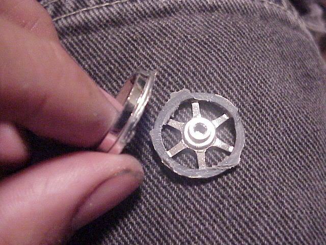

2. then after you pick which one you want, use your dremel and cut it right in half at the center bulge
http://img.photobucket.com/albums/v343/atmdc/tutorial%20for%20rims/MVC-009F.jpg
3. you should have something similar to this, discard the part with the spokes, or keep it for another project you may have in mind :iceslolan

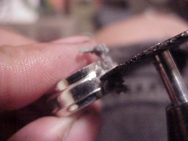

4. now take the other part that is just a ring, and shave the rest of the center bulge off, trying to keep it as even as possible
http://img.photobucket.com/albums/v343/atmdc/tutorial%20for%20rims/MVC-011F.jpg

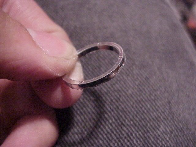

5. you should now have your wide lip, make sure that you fill in those 4 little circles on the lip (i havent done that on myne yet), then just glue it to the wheel, paint them and slap the kits original tire on them

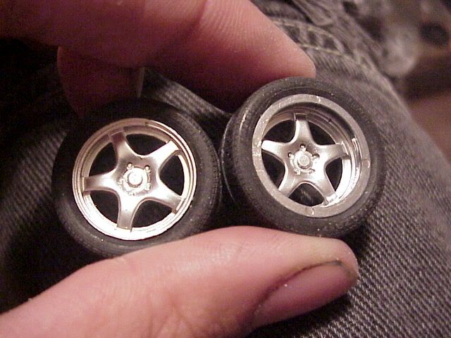

here are some before and after shots of the wheels i tested this out on, they are not painted yet, but i will use this on my RX-7 project :biggrin:
http://img.photobucket.com/albums/v343/atmdc/tutorial%20for%20rims/MVC-014F.jpg
http://img.photobucket.com/albums/v343/atmdc/tutorial%20for%20rims/MVC-015F.jpg
