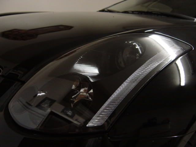

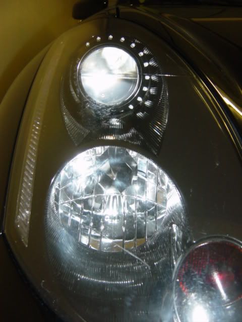

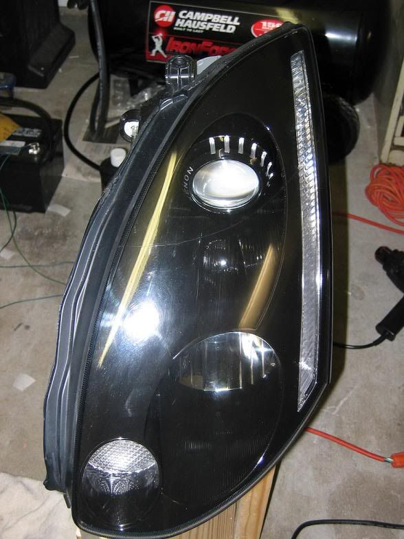

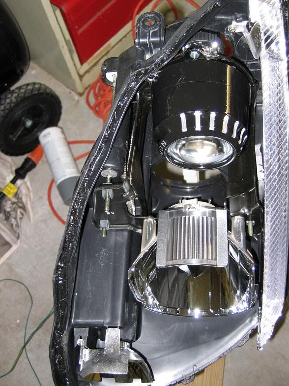

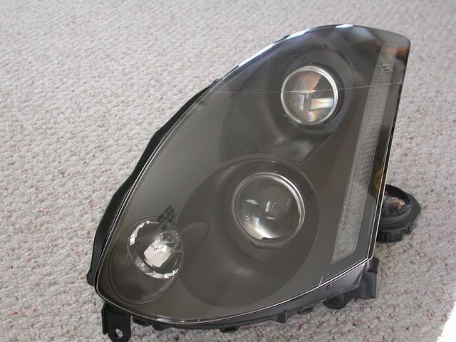

Why would I retrofit an HID projector into G35 HID reflector headlights? Look at the pictures below and tell me you wouldnt do the same! haha ;)
http://img.photobucket.com/albums/v69/Silverbo1t/headlightsidecloseup.jpg
http://img.photobucket.com/albums/v69/Silverbo1t/DSCN6229a.jpg
http://img.photobucket.com/albums/v69/Silverbo1t/headlighttop.jpg
http://img.photobucket.com/albums/v69/Silverbo1t/blackedoutfront.jpg
http://img.photobucket.com/albums/v69/Silverbo1t/386655_409_full.jpg

Doesn't look bad, but I guess I've never been a fan of retrofitting, LOL. At least it comes with HID's, LOL :biggrin:. Better than our cars come with stock, LOL.
