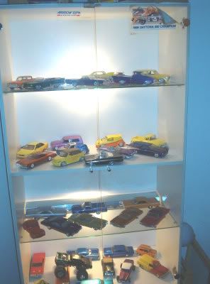

SoCalMark
04-14-2005, 12:58 AM
My case is white and the lights are aimed at the back, and the light reflects at the models. The lights are low watt lights like in a aquarium.
Mark
http://img.photobucket.com/albums/v25/650Mark/IM002462.jpg
rotatox
04-14-2005, 04:29 AM
Mark
that looks good, however a bit hard to do with my cabinet....i think im stuck with getting downlights. ill just try to minimise there use, which kinda defeats teh purpose
