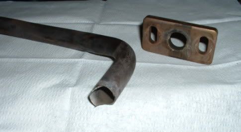

Found the problem...The pipe (Front right of engine) feeding the EGR valve has a hairline crack at the flange which is where the noise is coming from...which is why when the engine warms, the EGR valve opens causing less back pressure at the leak and the noise going away...temporary fix...muffler cement at the crack.

I just now got done replacing that EGR pipe. Exact same symptom as you had - except mine got worse and very obnoxious. Also I was getting headaches while travelling. It also was a major pain-in-the-ass to replace. I had to pull the air tube from the throttle body, air filter box with air flow meter. Then the EGR pipe wouldn't come loose on the EGR valve end. I had to very carefully heat the EGR valve (with a propane/oxygen torch) and use a 27mm open end wrench to get it loose.
http://i5.photobucket.com/albums/y158/kmohr3/DSCF0010.jpg
http://i5.photobucket.com/albums/y158/kmohr3/DSCF0009.jpg
