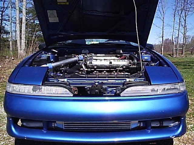

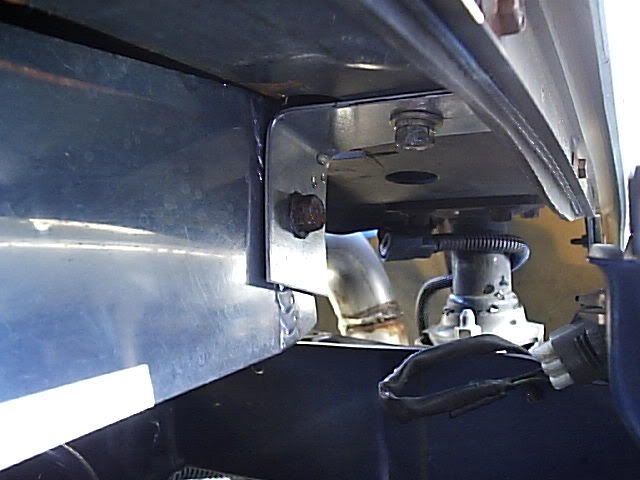

i thought i would try to give people an option to high cost fmic kit prices that cant afford them and that are on a budget.
EBAY USED FROM AN RX7 OLDER SPEARCO FMIC BAR AND PLATE INTERCOOLER 3.5-8-29 IS THE DEMENTIONS.COST $155.00
http://img.photobucket.com/albums/v642/courtlyn/P7110014.jpg
THIS IS HOW I MOUNTED IT TO THE BUMPER SUPPORT.
http://img.photobucket.com/albums/v642/courtlyn/P8130049.jpg

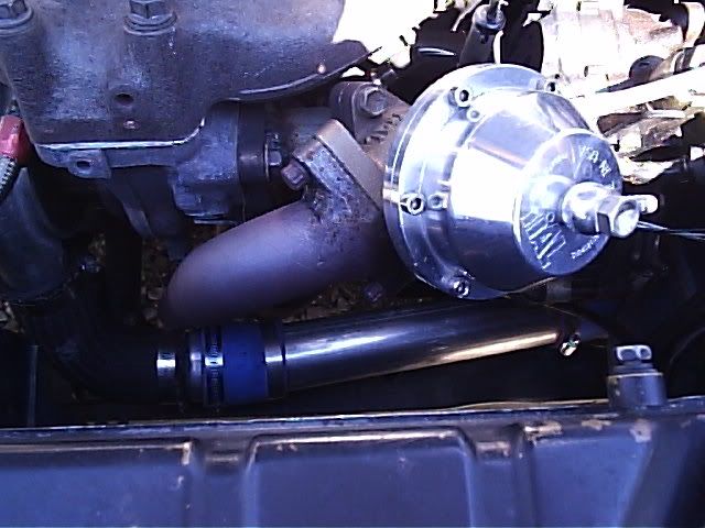

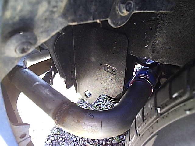

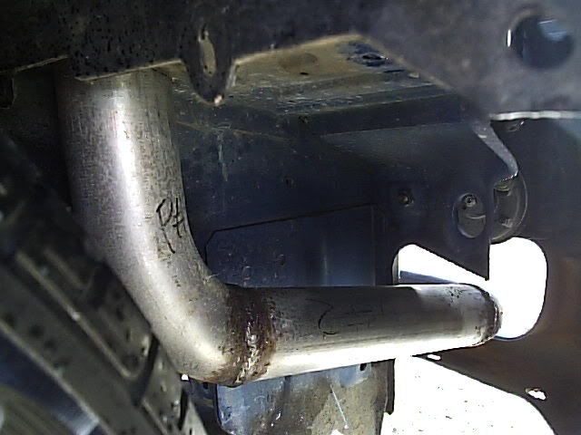

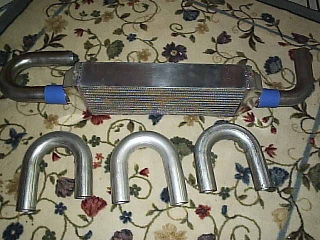

I USED 2 2.25 U BENDS 1 90 2.25 AND ABOUT 4 FOOT OF STRAIGHT PIPE AGAIN FROM EBAY.COST $57.00
http://img.photobucket.com/albums/v642/courtlyn/P7220018.jpg
http://img.photobucket.com/albums/v642/courtlyn/P8130045.jpg
http://img.photobucket.com/albums/v642/courtlyn/P8130047.jpg
http://img.photobucket.com/albums/v642/courtlyn/P8130046.jpg
http://img.photobucket.com/albums/v642/courtlyn/P8130048.jpg
http://img.photobucket.com/albums/v642/courtlyn/P8130044.jpg

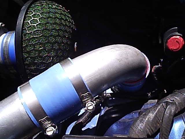

I GOT 5 2.25 SILICONE AND CLAMPS FOR $35.00 AGAIN OF EBAY.I CUT ALL THE PIPE WITH A SAWZAW AND IS WAS NOT THAT HARD.I HAD A LOCAL WELDER WELD EVERYTHING FOR $35.00.
THE UPPER IC PIPE WAS MADE FOR $30.00 NEW FLANGE WELDED ON ALSO.
TOTAL PRICE FOR THIS PROJECT WAS $312.00
SORRY ABOUT THE CAPPS BUT, I HOPE THIS HELPS US LOWER BUDGET GUYS!

nice job, but why didnt you throw a 3in GM MAF in there while you were in the area?
1g90gsx
04-03-2005, 12:18 PM
i used the stock intercooler hole and thats where it comes up from the bottom from the fmic.i guess it just made its way into the pic is that what you mean?
