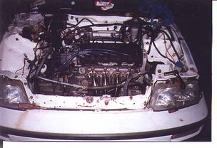

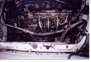

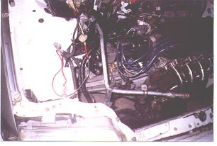

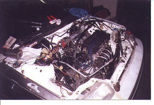

i turned the dizzy towards the front of the car and it seemed to want to fire a little bit better but not much better, the plug wires are in the same place they were when i got the motor and also in the same order as my old motor so i am pretty sure they are all in the right place. Here are some pics of the plug wires, i don't know if you can tell much though. My dad is coming to town tomorrow so i'll get him to bring his timing light. Can the timing still be 180 degrees out if the marks on the crank pulley line up when the cam gear mark lines up too?

get all your timing marks lined up then pull off the distributor cap and see where the rotor is pointing. if its pointing to a 11 or 12 o'clock position (top left corner) thats good, if its pointing to a 5 or 6 o'clock position(bottom right corner), that means the distributor timing is 180 degrees out.
