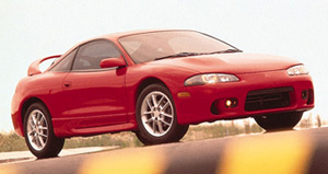

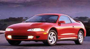

Stoned Raider
04-12-2002, 08:51 PM
the front bumpers are different too
95-96:
http://dsmtuners.com/images/eclipse95-96.jpg
97-99:
http://dsmtuners.com/images/eclipse97-99.jpg

Okay, here's what your looking for:
The pictures posted above show most of the external cosmetic difference between the 95-96 and 97-99 models. The front bumper, side skirts, rear bumpers, rear wing, headlights, foglights, reverse lights, and third brake light are all different.
