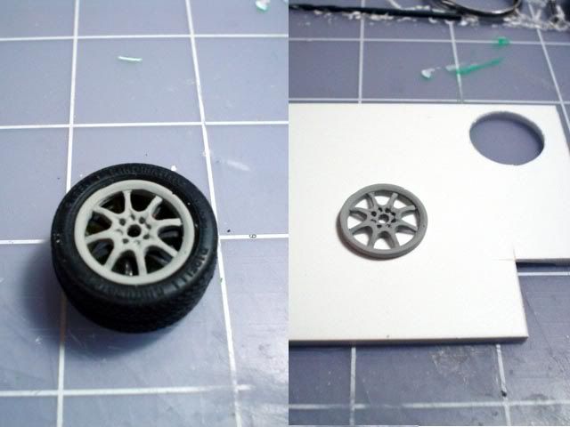

I'm always trying to do something new. For the most part, it's only plastic. Just recently I've finally grown to where I'll try most anything.
I really want to make a model of my car, but no one makes Konig Helium rims, and without those 10lb wonder wheels, well, the model just wouldn't be my car.
After many many tries with varying success (mostly with other wheel styles) I've finally scratchbuilt a viable wheel. I am so happy I could just hug everyone here. Thanks limited24 and your Ferrari build that included the method I used here, and thanks Flyonthewall for the "You don't need tube if you have old wheels" revalation. What had I been thinking?
And sorry everyone, just bare with my pride for a moment. This thread will tank and it'll be over soon.
http://img.photobucket.com/albums/v417/willimo/scratchrims.jpg

I made it essentially like this:
Limited24's "how to" (http://www.automotiveforums.com/vbulletin/showpost.php?p=1778919&postcount=52).
A couple differences: I used a single, thick piece if plastic sheet, which I cut out with drafting dividers (like a compass with two points). I used a metal axle (probably from a Revell kit?) through the center hole to chuck the disk. Otherwise, that's how I did it.

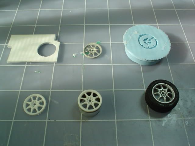

Seems like a HUGE mold for that size part... :confused:

Well, actually, it's just the right size, in my estimation. It's big enough to not flop around while the resin in the mold. More importantly making it that size makes creating the mold easy - I supergle the part to a sheet of styrene, take a mixing cup and flip it over, cut the bottom out and clay it down the the styrene. Making the mold box takes a grand total of 1 second, and that's the hardest part! (Besides waiting.)

http://img.photobucket.com/albums/v417/willimo/progressions.jpg
And now I have four. Weeee!
That came out soo nice:)
I NEEEEEEEED to learn how to do all those resin casting stuff! I wish i could make some GAB wheels or some Work RSZ-R:(
