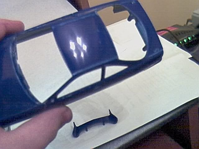

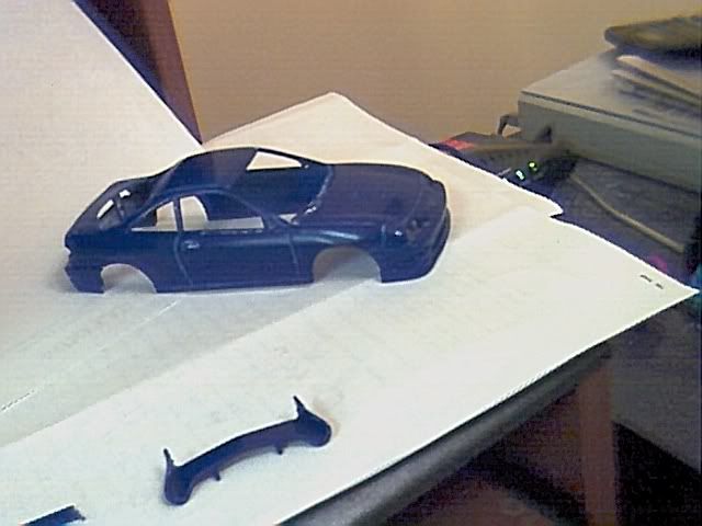

I have been working on this for about 2 or 3 days and I still can't figure out why it wont shine that great anyway this pics arent all that great so from what you see tell me what you think.http://i3.photobucket.com/albums/y96/injecting/integ4.jpg
http://i3.photobucket.com/albums/y96/injecting/integ3.jpg
http://i3.photobucket.com/albums/y96/injecting/integ2.jpg
http://i3.photobucket.com/albums/y96/injecting/integ.jpg

good start, did you sand/compound and wax?
injecting
03-27-2005, 06:50 PM
I didn't sand it I compounded it and I'm still trying to find some wax. But thanks for the comment.

You can get a good shine with just poish, but it will take a loooong time. You likely need to use sanding pads/paper to level the paint, and then you can polish it.
What kind of paint is it, and how long did it cure before you polished it?

Its just testors paint and I let it cure for about a week. I'm poalishing it with TurtleWax, Also thanks for the comments.

you will most likely not get a very good shine if it is a metallic color. I suggest shooting a couple layers of clear and wetsand/polish the clear, you'll get a much better shine this way.

If that is Testors enamel, you need to wait a rather long time before polishing will take. Enamels notoriously take a long time to cure hard enough for polishing to work properly. Also, wax does not polish. Wax is... wax that you rub into a surface so that it fills tiny scratches, evening the surface making it smooth and shiney. To polish you need a polish, a polish is a fine grit that grinds out the tiny scratches, making the surface smooth and shiny.

You should get Meguiars ScratchX and polish it out once again and then put on wax or something:) I've never used wax :screwy:

No the paint is acylic. I'm going to have to get some of the meguiars srcatchX then and try that thanks for the help, I working on it now and will get some more pics up soon ( even tho they will be shitty ).

Update there has been a problem with the paint and I had to strip the whole thing and I'm going to repaint it red. Well it's raining right now so I have wait to paint it but I'll try and get pics soon.
