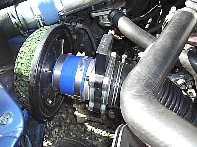

i have had mine for about two years and have had good luck with it.you will feel a smoother throttle responce even on a stock set up car plus, all the benefits the maf-t has to offer.
needed for maf-t for draw through:like myself,till next week going blow through
the translator itself
gm maf sensor itself 3 or 3.5
3 inch filter
HERES A PIC OF MINE,HKS FILTER TO STOCK INTAKE HOSE
http://img.photobucket.com/albums/v642/courtlyn/P7310039.jpg
MINE MOUNTED INSIDE THE CAR
http://img.photobucket.com/albums/v642/courtlyn/P7310038.jpg
