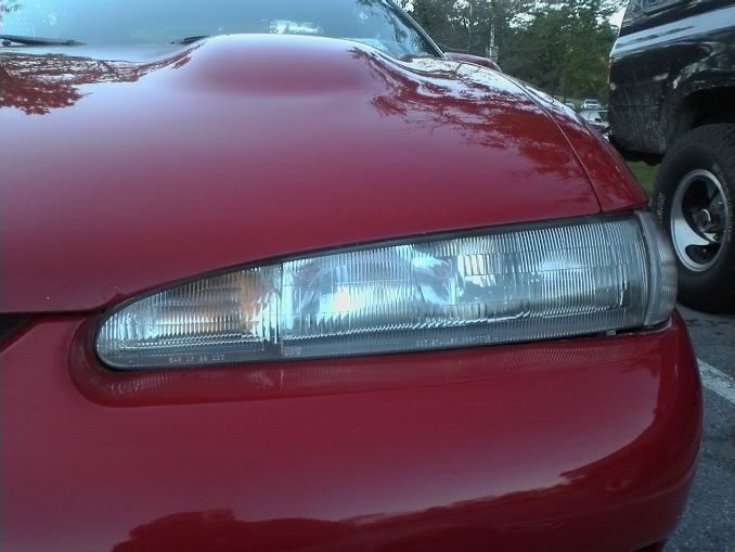

EDMUND65
09-07-2005, 11:49 PM
http://i13.photobucket.com/albums/a285/crazydriver7686/right2600x500.jpg
you have to use sand paper and wet sand and buff. works amazing as you can see....

96spyderman
09-08-2005, 08:27 AM
Save yourself the time and BS of wet sanding... Find a product called NOVUS.. use the #2 compound first and follow up with NOVUS #1
You are looking at about 5 minutes a light/lense
