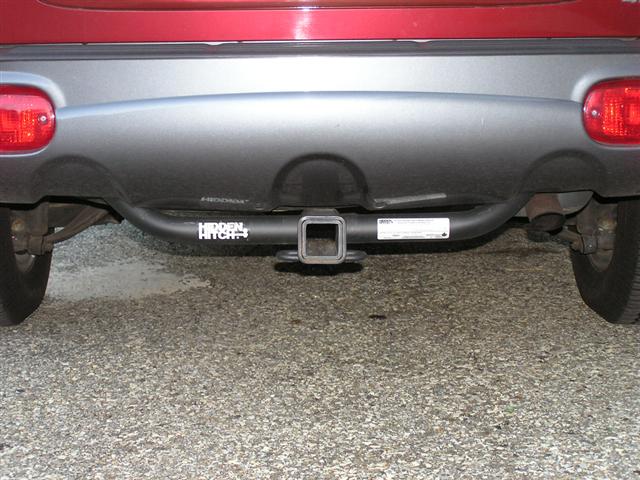

The Hidden Hitch brand has the entire frame hanging below the rear bumper. (Note: their website states that their model won't fit the 4 cyl Santa Fe, although a few owners have made it fit, but I do believe they sell one specifically for the 4 cyl)
Install Instructions here (http://www.santafemods.com/images/Hitch/HitchInstructionsHiddenHitch.pdf).
