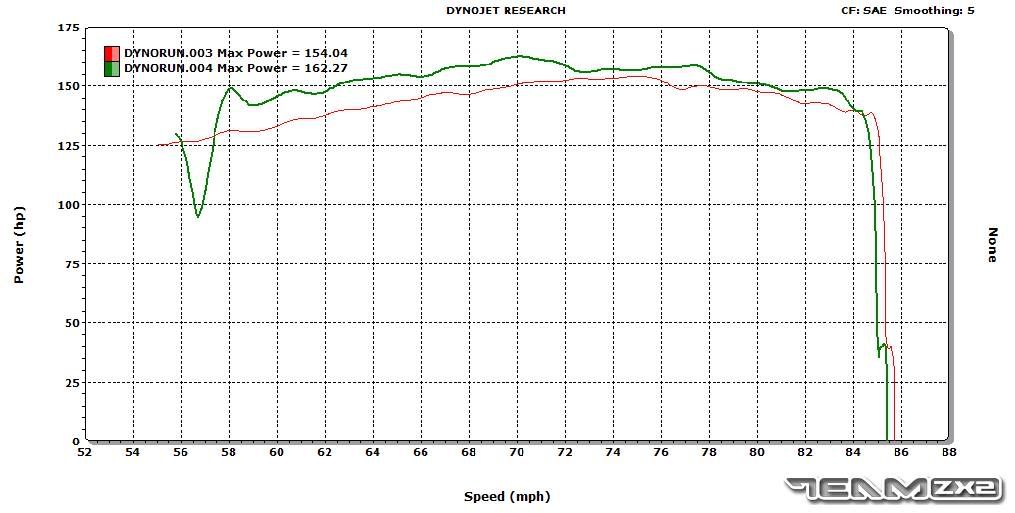

the dyno results can be found here. soory for linking but i cant figure out how to post them on here.
http://www.teamzx2.com/index.cfm?fa=forum.viewThread&thread_id=84627

272.8mmHg.... fyi that is 0.36atm or 5.27psi that is a HUGE pressure drop... but there is still the same ammount of oxygen. what you will be doing when you do this is causing manifold pressure to drop while keeping the moles of oxygen/litre the same.
Granted it will give a small HP increase you will not see the major increase of power like you will with nitros oxide because nitros oxide is just as cold but it contains more oxygen/litre than air.
http://img.photobucket.com/albums/v201/CBFryman/what.jpg
that is one funky second run.
