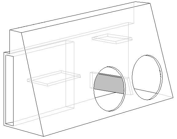

a friend of mine has 2 JL w0 10's ported in his S10 single cab with the seat on the 2nd to last notch... here is how you can port it...
http://img.photobucket.com/albums/v201/CBFryman/boxChevyFullSizeStdCab.jpg
(courtesy of DDaudio.com)
i will draw you up some plans this weekend if someone doesnt beat me to it to give everyone a taste of my designs...

Honestly man I don't think you have enough room to port..... and if you do port use two 4" circle ports because they will take up less box volume then big slot ports......3" would work too...... but I seriously doubt u have enough room to port.

im messin around in winISD.... seems a 2cuft enclosure using 1/2" MDF wtih some bracing and a 2"x8" port could work but im just brain storming right now....
