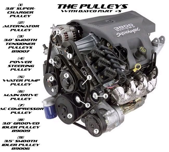

This pic should help you out,so you can tell use which pulley.
http://img.photobucket.com/albums/v285/BIG-L/snaps023.jpg
adamfigge
02-19-2005, 10:57 AM
its number 3 but it doesnt look like that right now its metal

You're in luck. 12.99 @ napa. New one will be metal.

You probably don't need the tensioner. So just ask them for the tensioner pulley.
adamfigge
02-19-2005, 11:11 AM
do what i thought what i needed was the tension pulley idler pulley is different isnt it
