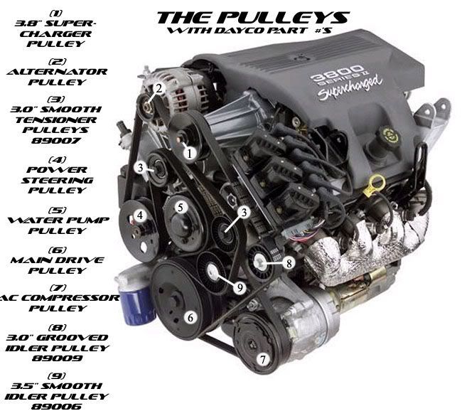

kustomkid54
02-11-2005, 07:57 PM
Just remembered I had this. May help. To the left of "3".
