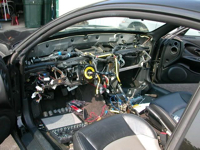

heres my car when i took the crashpad out. you will need to do the same.
http://img.photobucket.com/albums/v132/luigi3011/DSCN1993.jpg
here is what i went by...
http://www.hmaservice.com/webtech/iindex.asp?id=12232#_12232
you will need a steering wheel puller. like 12 bucks at autozone. it would be a good idea to get a angled socket attachment too; some of the bolts are hard to get at. you will also need a set of star bits. cant remember exactly what size. i dont even know if they are called "star bits", but i had one handy luckily. said t1.5 on it or something.
there is no easy way to get the pass airbag out. you WILL need to take the crashpad out.
