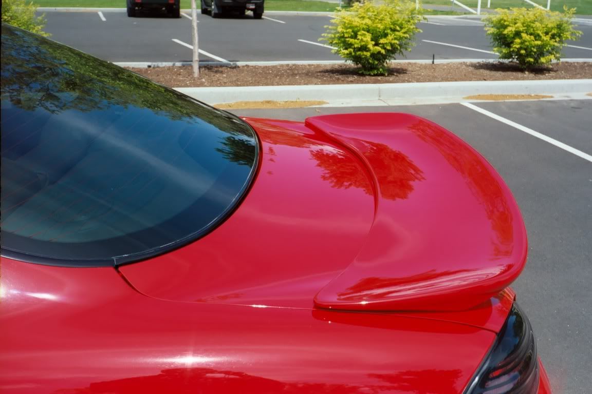

Was out washing the car today. It was 72, and sunny. Had to throw that in, only good thing to happen all day.
When I got done, open the trunk to dry edge of trunk. This is my luck. The inside of the trunk was wet. To tell you how wet it was. I took the floor mat out to dry. Noted that there was water on spare tire cover. So, I took that off. Then seen 2" of water in the tire well.
Checked seal for trunk, not a drop. The I looked at the deck lid. Had water dripping off nuts for spoiler. Seems that the body shop, when they romved spoiler to repaint truck lid for the thrid time never sealed spoiler.
Right now the car is sitting in the sun, trying to dry the trunk out. Pulled plugs out of trunk well, and got my feet wetter then when I was washing it.
Now I have to take it back, for the 17th time and let them work on it. I'm so tired of this crap. Should just go out and by a bike.

On my SLP spoiler I used some rubber washers between the spoiler and trunk lid,which you can buy at Lowes in the nuts and bolt section,they where with the rubber plugs and corks.The washers are about an 1 OD, 1/4 inch hole ,1/8 th thick.Then over in the nuts and bolts section you can buy a package of bonded neoprene washers to put on the inside of the trunk lid 5/8 OD - 1/4 SCR Part # 35020.
I heard alot of storys about leaking spoilers before I put mine on,so that's what I came up with.I tested mine at a high pressure car wash and never had a problem.It now been almost 2 yrs with no leaks in the trunk.

Thanks Larry. Will give them the list of parts they need to buy. It didn't leal a drop till they had to take it off to repaint both times.

I also put rubber washers in but coated them all with a thin layer of silicon sealant first. No leaks since.

I gave them the washers and print out how to do it. They said it can't be done. He said (sorry about this) "It looks like shit".
Thats why I chose, thinner rubber washers :biggrin:

Well just got off phone with the body shop. They told me that it's not their problem. They only painted it.
Told them that it was fine till they removed it. He said they won't warrenty the gasket. Asked them if they will warrenty the "peel" I have on the trunk. They told me to bring it in tomorrow.
This will be the last time they touch it. IF it's not 100% this time, I will take them to court and try to get my money back.

Went to shop today. They pulled it a part, and did it your way. The guy said "It's fixed". I said good, let's go for ride. Took him to the car wash. Opened trunk and told him to get in. After a short talk with a lot of four letter words, he did. When he came out the other side, NO WATER IN TRUCK. Either that or he was drying as fast as he could.
But thanks for all the help. Will keep and eye on it.
